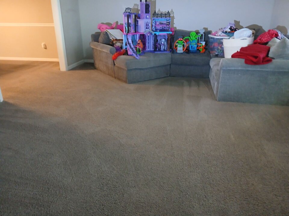

Yesterdays job. She gets this done every Year in December. Just a Living Room and Dining Room
Used VacAway Double Trouble at 2 oz VacAway Detonator at 5 oz
Tankless Vibe with 2 weights on each side
Scrub with 14' Brush Master Pro CRB
Groom 10'' CRB
2 Bonnets for each Room
2 TOPS Glad Pads for Dining Room
2 Bonnet Pro Ironman for Living Room
LESS water MORE agitation !!!

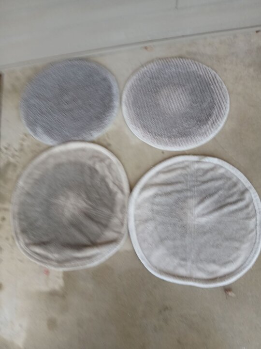

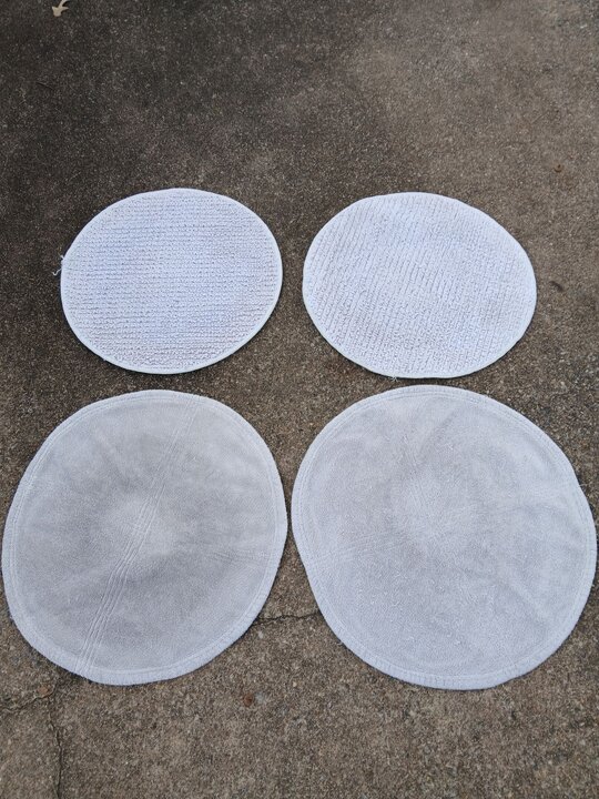

There are the 4 Bonnets I used yesterday
Hot Water and Procyon Plus Powder does a good job at cleaning Cotton Bonnets
Bonnet Pro Ironman on Top
TOPS Glad Pads on Bottom
Bonnet Pro Ironman are excellent Bonnets. They really grab the carpet and extract dirt. They're my favorite Bonnet for filthy Residential Carpet
And they clean up better than any other Cotton Bonnet

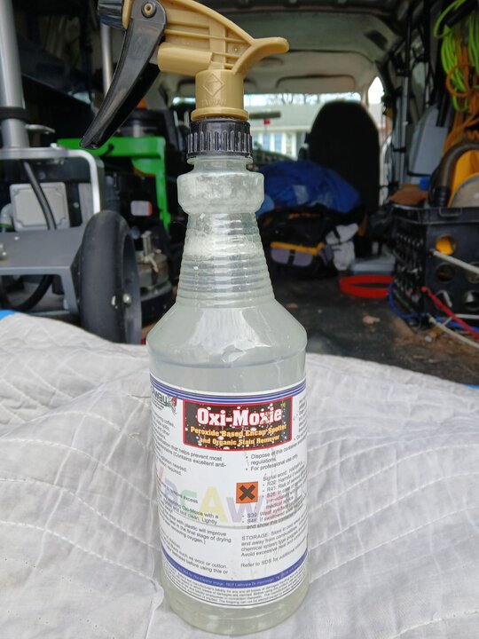

Straight, On spots.
Plus I add it to Carpet Details [I love that stuff!!!]
No HEAT....
I use VacAway Oxi-Moxie for urine stains and many other stains
It's a strong Peroxide based crystallizing anti-resoiling spotter
And it also prevent stains from coming back
I carry it when I'm vacuuming and just spray it on stains as I go and usually they're gone when I start cleaning
THANK YOU VacAway !!!
