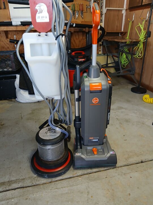

So many things you can do with a175 and few other pieces of equipment.
Like a small portable and water claw.
It is slower some times and some times it isn't ?
But you can clean just about anything with VLM!!!
I got a lot of experimenting to do with a 175-300 to see what works for me
To start I will use it to put down cl02 using a Fiber Pad or Bonnet Pro Multi Brush
Then put down prespray with WORX Sprayer and CRB with 14'' Brush Master Pro
Then extract with 175-300 and Microfiber
Then groom with 10'' CRB
I'm replacing the OP with the 175-300 for jobs using cl02

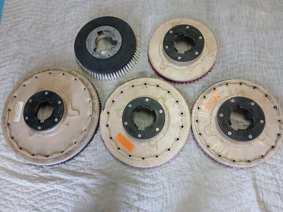

I have the 17'' Bonnet Pro Multi Brush and 14'' 15'' Drivers that have holes to shower feed using a Fiber Pad
Just got to be very careful near baseboards with oversized Driver
12'' Driver and 12'' Brush doesn't have the shower feed holes
I got a lot of practicing to do at my Apt Complex before I use this on a customers carpet
Gotta put down enough solution but not over wet carpet either
No customers around on Apartments so I can practice putting the right amount solution down

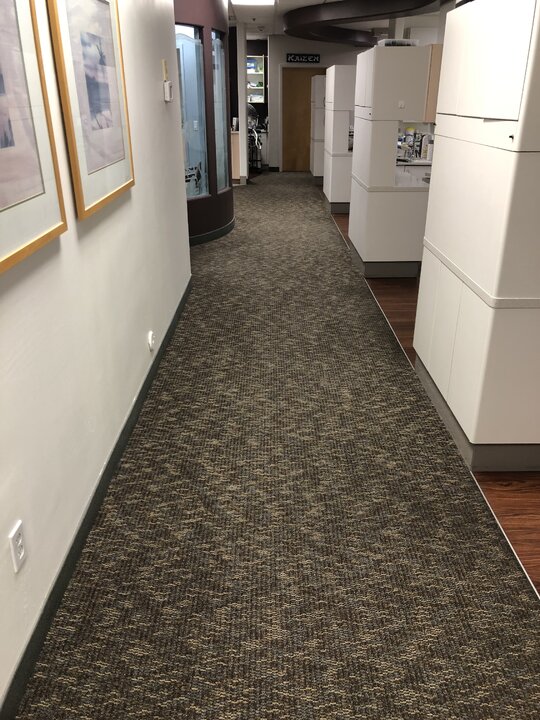

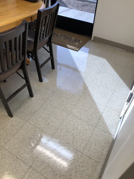

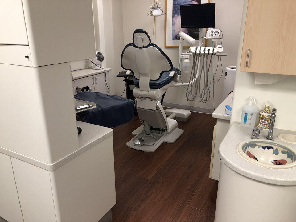

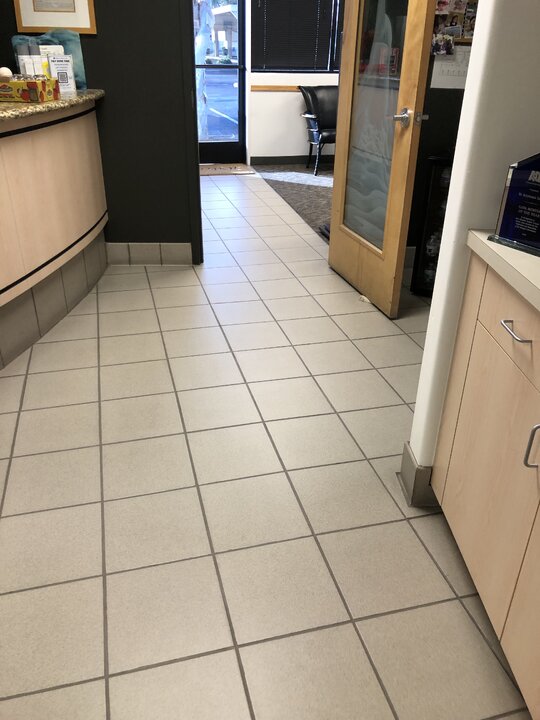

Fridays/Saturday job
Luxury vinyl, tile and grout, vct and cgd.
For clarity on the vct I used a square scrub and spp pad to do a scrub and recoat, so the round marks that look like circles are old.
I did the carpet with the Bonnet Pro Multi-Brush. It was fast and removed all dark travel paths tracked in from the asphalt parking lot. In Phoenix it's extremely hot for half the year and oils get tracked onto carpet. In case anyone cares I used Encapuclean and peroxide on the carpet.
I like the heat of the Ninja during the extraction, it helps in rinsing and removing the slurry off of hard surfaces so it doesn't dry to the floor.
One weekend I did a strip and applied 4 coats of finish on my first vct job (at another medical practice) and the employee who was supposed to be there took off for a couple hours.
Somebody came in and was in the file room going through their records when the employee came back.
The employee didn't lock up and had the audacity to ask me why I let them in, I told him I didn't let anyone in and I didn't see anyone come in because I wasn't in the area in question.
I like that a portable doesn't require open doors, letting me work without concerns like strangers having access to the building or my trailer.
View attachment 133496 View attachment 133497 View attachment 133498 View attachment 133499

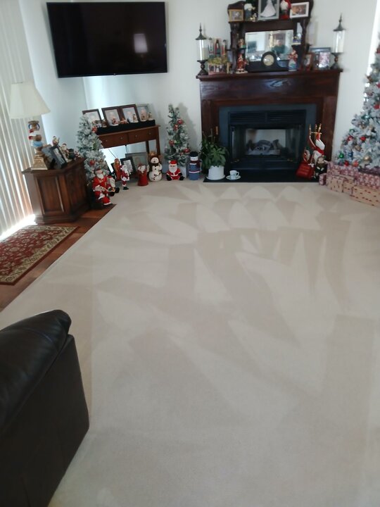

One job today for long time customer with old nylon. I go to this house 2 times a year
I'm using Carpet Details with 5 oz of peroxide
You say no heat
A few years ago when it was my main cleaner I thought I got better results using Carpet Details with hot water
It's cold 25 degrees and I take my own soft water. So that water is cold when I get to customers house
I put a bucket heater in jug when I get there so water is at least warm 80-100 degrees when I start cleaning
Is that ok ???
You say no heat
Is that ok ???
Yes, warm is OK , not hot.
Here in Florida water is always 80' or Hotter LOL!----[ I haven't took a cold shower in five years LOL! ]

Frank after I finished I went back and checked on the 3 Bedrooms
The carpet was nice and SOFT and DRY
I did 3 Bedrooms and a Family Room
Used Carpet Details at 5 oz and Detonator at 5 oz
LESS water MORE agitation !!!
